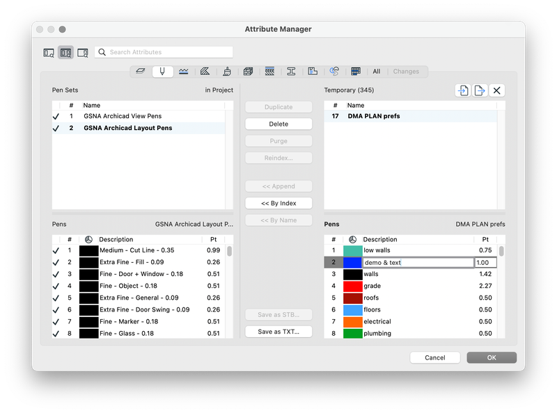

This can be done with the Attribute Manager... (not to be confused with Attribute...).

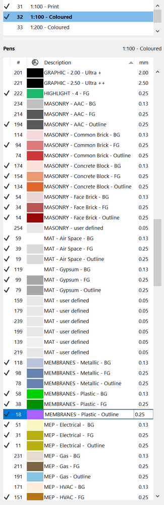

I have a number of spreadsheets that programmatically handle the organisation of various attributes en masse; hopefully the examples below might be of help to those managing large teams (which has been my job for Archicad since 1999)
Once you hook up the xml into it, so useful for many things.and makes it very easy to really get a lightning fast ui/ux and overview which is difficult trudging around the ui...but doing that manually in the dialog or AM is really painful in comparison...:(
eg

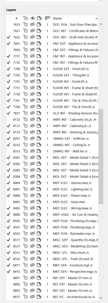

or for logical layer management at a glance
generates mnemonic tags so you simply type the first letter of each phase to drill directly, in many cases, 3 or 4 characters
mnemonic extension "(W)all (E)xternal (W)all" (but I realise now, this should just be "we/e or n)"
