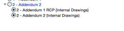

I am trying to use the revision tool for the first time and I somehow locked some revision schemes that I want to delete. Any clues on how to unlock them? I have the entire project reserved. Thank you in advance.
6 REPLIES 6
Well I figured it out....
I had views on manual update showing old deleted bubbles. I had to update the views do a send and receive, release all. Quit the file and re-opened. Then it worked.
