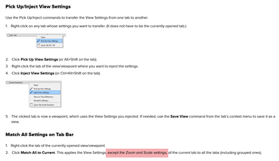

Seems it might be by design.
In the reference guide, it doesn't say specifically for pick up / inject settings, but for match settings, it does not include scale or zoom.

I never would have thought that would have been documented!!
