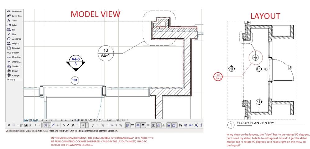

in the model view, the detail marker head is horizontal, yet when I place the viewmap on the layout, I needed to orient the view in a 90 degree rotation.
therefore, the detail marker head is now no longer horizontal....how do I get the marker head to display properly so that it reads horizontal on the layouts. I know it will be rotated on the "model" environment and that's ok.....I just need the detail marker to rotate 90 counterclockwise so that it reads correctly on the "layout" (sheets).

OK, I guess I should have mentioned that "that view" is coming from the model itself. it's not a clipped detail 2D linework view...it's merely an enlarged view of the entry with a different layer combo, different penset, etc...but I can't very well rotate the entire model now can I?
I just need that detail marker head to be able to be rotated 90 degrees counterclockwise is all.

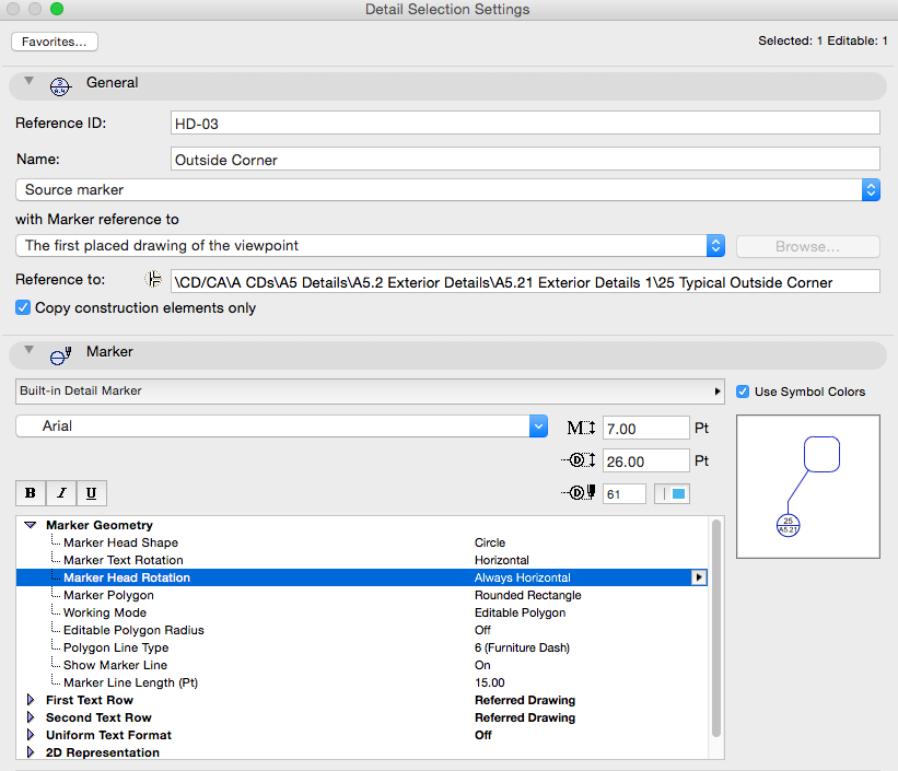

First check the settings in the detail.
Go to Marker Geometry > Marker Head Rotation > Always Horizontal
Then make another view and rotate it 90 degrees, save that view as such then place it on the layout.

if I select "Always Horizontal" i think that sets it to "always horizontal AS IT IS IN THE MODEL ENVIRONMENT".....but that doesn't help me.
The model is rotate and STAYS how it is oriented the way it is......it's the 'marker head' I need to rotate as per my diagram on the OP.
