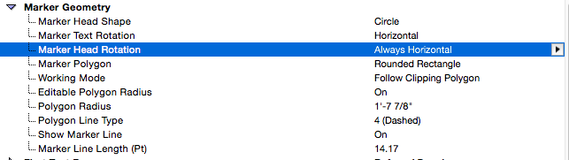

Ok maybe there is another setting to adjust in the detail settings.
I have attached the settings here. Make sure marker text rotation is set to horizontal and marker head rotation to always horizontal.

rob2218
very strange...I don't seem to have that "marker geometry" in the settings? I'm using an AC18 detail marker so I'm not sure what's up.

Sorry forgot to tell you to use the built-in detail marker or Detail Marker Simple.
