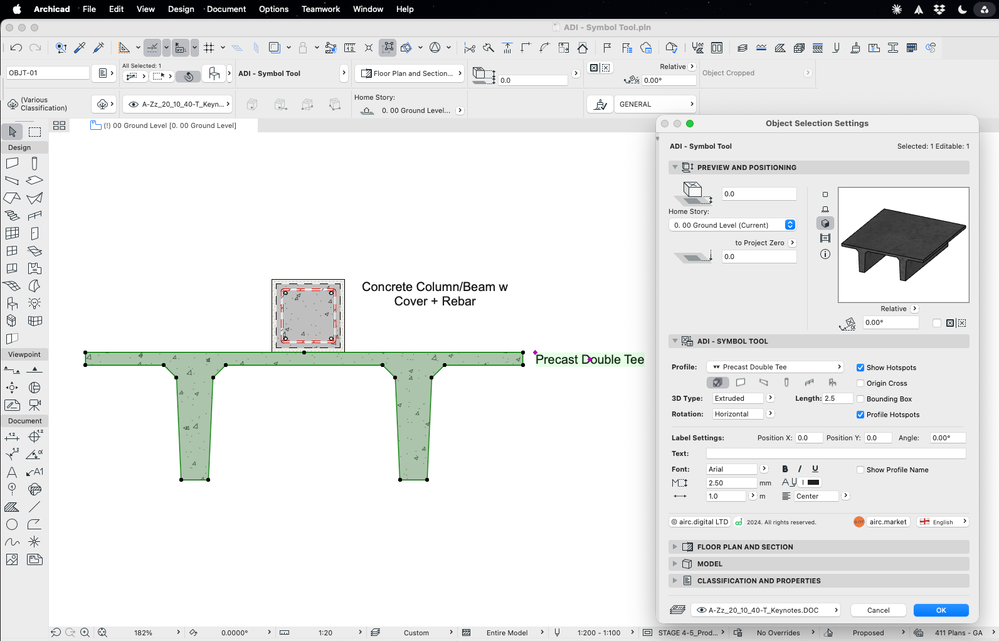

You are definitely right, this is a frustration a lot of us who transitioned to Archicad have felt when dealing with repetitive 2D detailing. Grouping lines and fills is incredibly tedious and breaks the parametric BIM mindset, but writing GDL code from scratch for every window extrusion or steel profile is overkill for everyday drafting.
The workflow you just described, using the Profile Manager to draft 2D detailing components and placing them as an object, is exactly why I built the ADI - Symbol Tool.
It functions precisely as the native detail object you are wishing for. You draft your shapes once in the Profile Manager using standard fills, and the object dynamically reads them. It automatically pulls the geometry, building materials, edge pens, and cut fills directly from the profile. It generates hotlines, origin, contour, and bounding box hotspots for easy placement and alignment. Because it relies entirely on the Profile Manager, any edits you make to the source profile update globally across all placed instances in your project, providing that type of AutoCAD block or SketchUp component behaviour you are asking for.
If you ever need to show those elements in 3D, the tool can seamlessly extrude them into flat or 3D representations, and it includes highly customisable text labels that can automatically read and format the profile's name. It essentially bridges the gap between 2D drafting and parametric object management levering complex profiles capabilities.
Let me know if this would be of interest to you and I would publish the tool.
