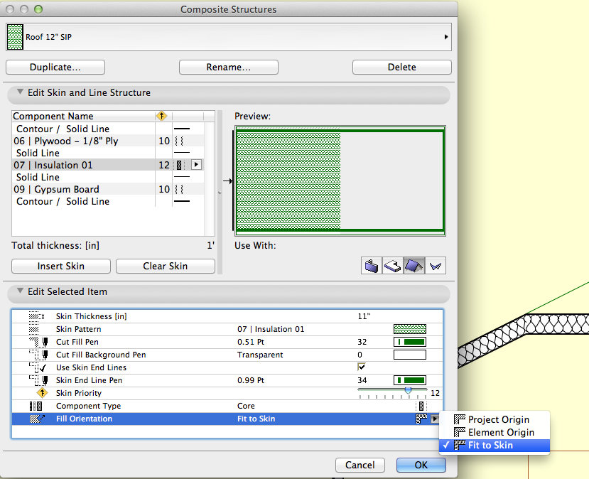

- Can I scale the hatching and choose the direction? I want to get the insulation pointing in the right direction and scaled to fit properly.
To have the insulation fill follow the direction of the skin that it is in, you must use a 'symbolic' type fill and choose 'fit to skin' as the skin fill orientation as shown in the attached screenshot. It is a shame that this feature does not work with vectorial fills, so you may have to construct your own symbolic fill.
