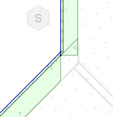

Different Thickness walls not intersecting
onestoreyllc
I have two thicknesss of walls with the same composite buildup and the same junction order, same strength of materials.  The walls are the same height in the same story and same layer.

onestoreyllc
Also here

Check your on screen view options especially Clean Wall & Beam Intersections.
thanks, my view options are set with clean wall and beam intersections on and thise is still the result

You may be on the same layer, but if the answer above didn't work then you need to look at your LAYER INTERSECTION SETTING
Lingwisyer
Guru
This cannot be 0
