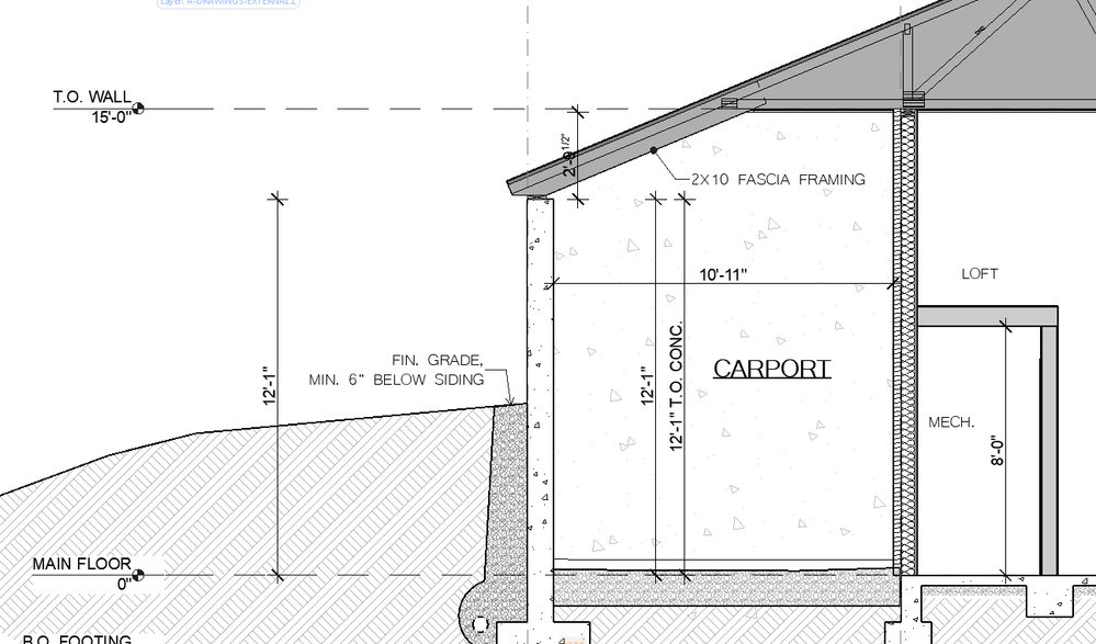

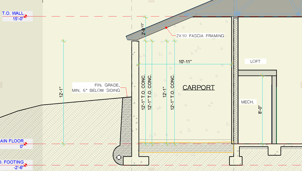

The dimension shows up in the View, but not the Layout, any ideas why? It has the same properties as the neighboring 8' dimensions showing up in both views.

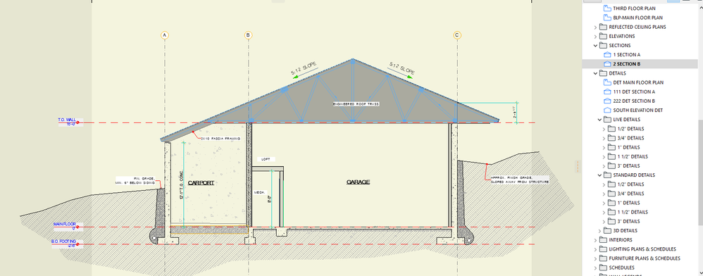

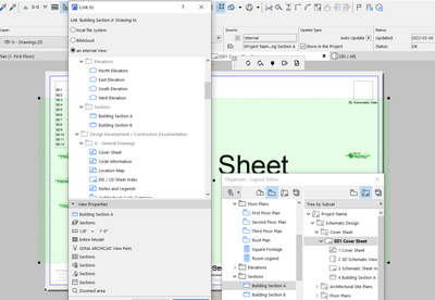

Hello, Thanks for the reply.  I looked into that and there isn't  a second view with that same name. I also tried linking to that view without any luck.
There is a another section view that I've renamed, both number and title, that is linked to this same view point, but it has different view settings.
