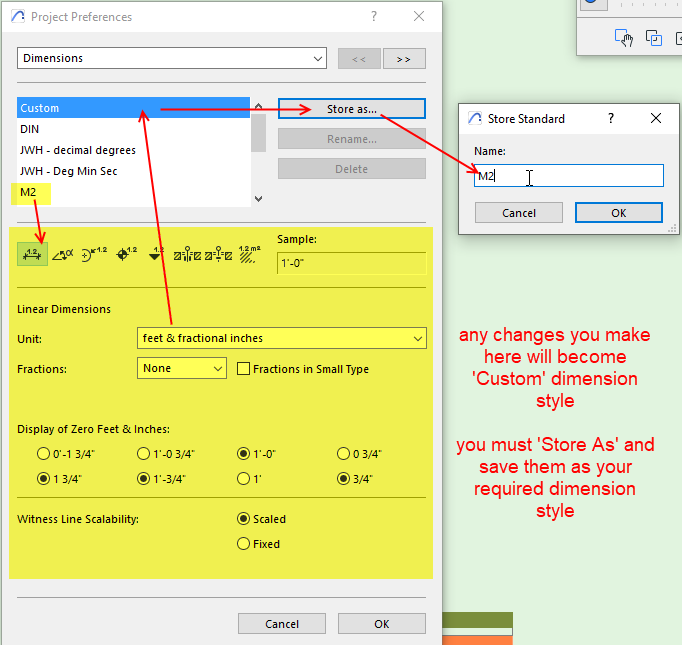

I dimension a plan
I go to Options
then Project Preferences
Then Dimensions Set as Feet and Fractional Inches
Then None for Fractions
then 1'-0"
Save and create by Name "M2"
Now I do into mile file to work and it will for a bit,
then I plot and find the fractions are back.  I have to do the same process and it works again for a bit but reverts back to fractions
I select the "M2"  and that works for a bit but then the file reverts back.
This has been happening in both 26 and 27.
Pulling my hair out and there id not much to pull.
Now I close the files and reopen.
First the Dimensions are not showing as I have to add levels that were previously showing.  ( Ctrl-L "Show All"  do a Ctrl-Save  as I assume this will save what you see.  AND my dimentions go back to fractions.
I File save all the time and dimentions dont stick.
And Levels don't stick.

I wonder if you are changing the settings in the dimension styles and then just saying OK.
That will only be a temporary change as the dimension style becomes 'Custom'.
You never want anything to be 'Custom' in Archicad.
If you make a change to the dimension style, you must 'Store As' the style you want to change.
Then it will be a permanent change for that style.
Any view using that style will now have the settings you want.
Change the settings > store as > all of the views using that style will instantly update to the new settings.
