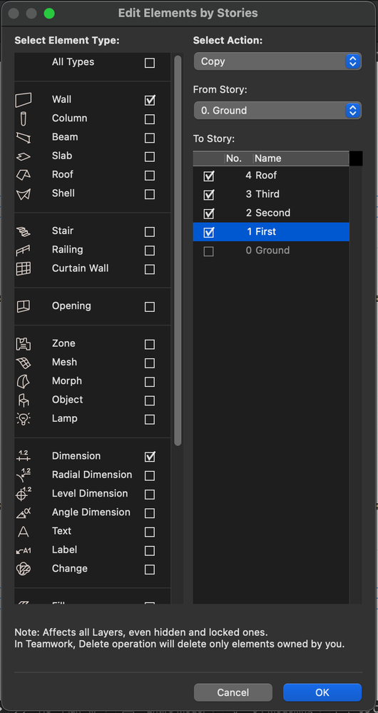

This trick should work for you:
Dimension one floor level with all of the dimensions you need. Then go to 'Edit Elements by Stories' which is found under the 'Design' menu. Untick all except for your Dimensions. Choose the levels you wish to have them duplicated on. The dimensions will be replicated on every level and remain associated to the walls on that level. See attached.
