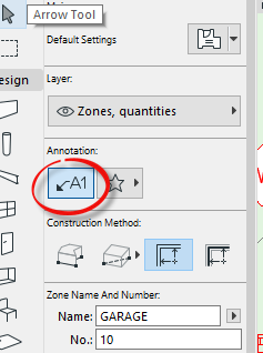

This might be stupid question but I can't figure out why there's a label automatically showing whenever I make a Zone.
Thanks.
Solved! Go to Solution.
2022-01-27 02:43 PM
That is the new way zones are supposed to work now in version 25 (have a look in the new features section of the manual).
They are supposed to be labelled now instead of using the zone stamp (which can be turned off/on in the model view options.
If you are happy to keep using the stamp then turn this option off in the zone settings before you create a zone.

Hi Barry,
Is it possible to turn this off so it will default to being off in a template file?
2022-09-09 04:58 AM - last edited on 2022-09-09 05:02 AM by Barry Kelly
As Barry has mentioned, it is a tool settting for the label and a MVO setting for the stamp. So within your template, you can update all the MVOs to have it on/off (the zone stamp that is - edit by Barry) whilst you will need to get each user to toggle the label in the zone settings before using it.
| Win11 | i9 10850K | 64GB | RX6600 | Win11 | R5 2600 | 16GB | GTX1660 |
2022-09-09 05:00 AM
Hi Yvonne,
It is not a file setting, so is not saved with the file.
It is a user setting, so if you turn it off it should stay off.
It is also not saved with favourites.
So if you turn it off, it should stay off - for you.
Of course each other Archicad user must do the same.
