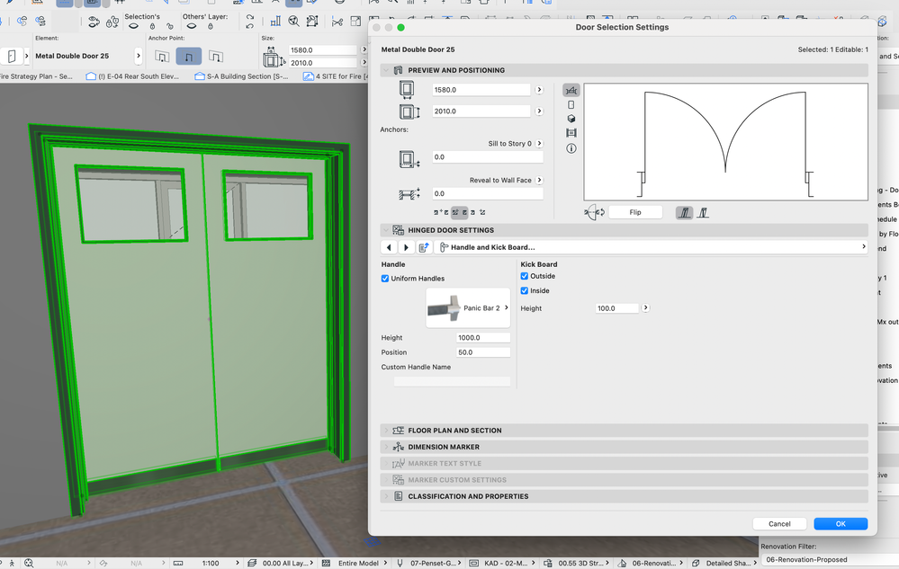

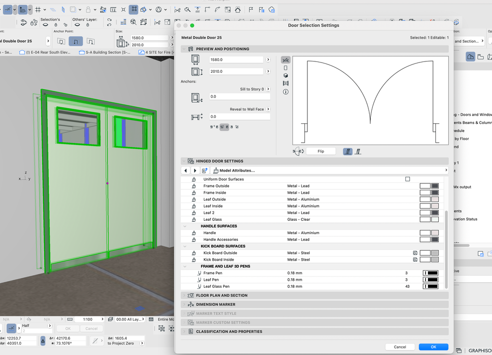

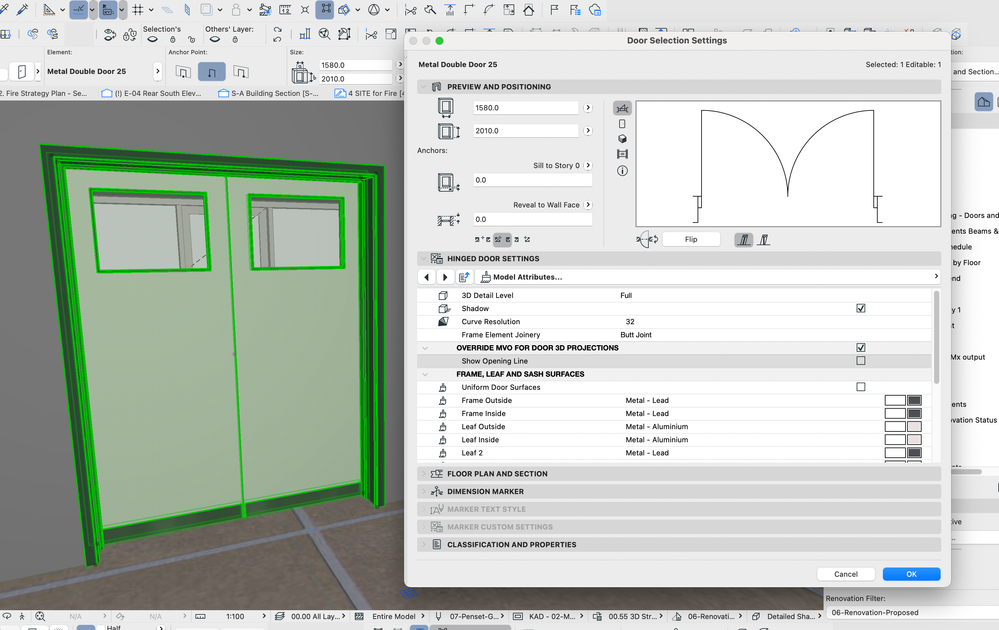

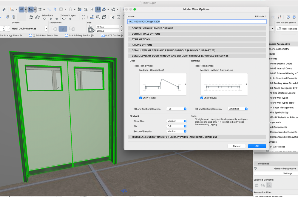

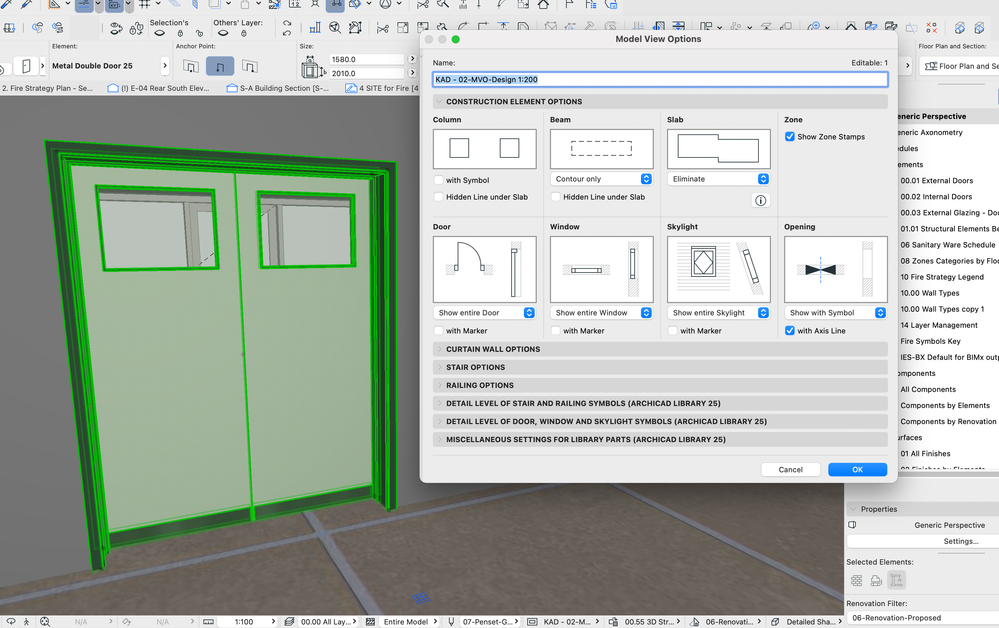

I've set some panic bars to my doors, and they are not shown in any of the views. I've set the doors to be shown as full in plans and elevations, and I've updated the MVO, and I can not see them. See the images attached.

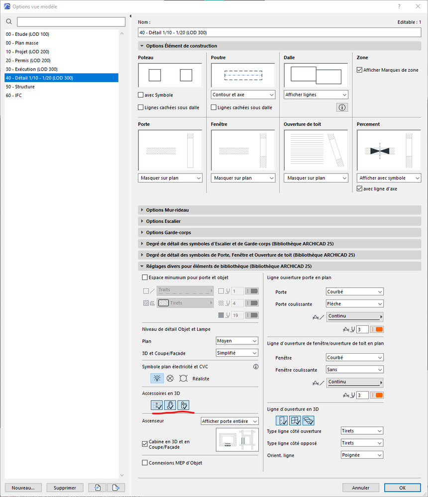

MaFarine
Hello,

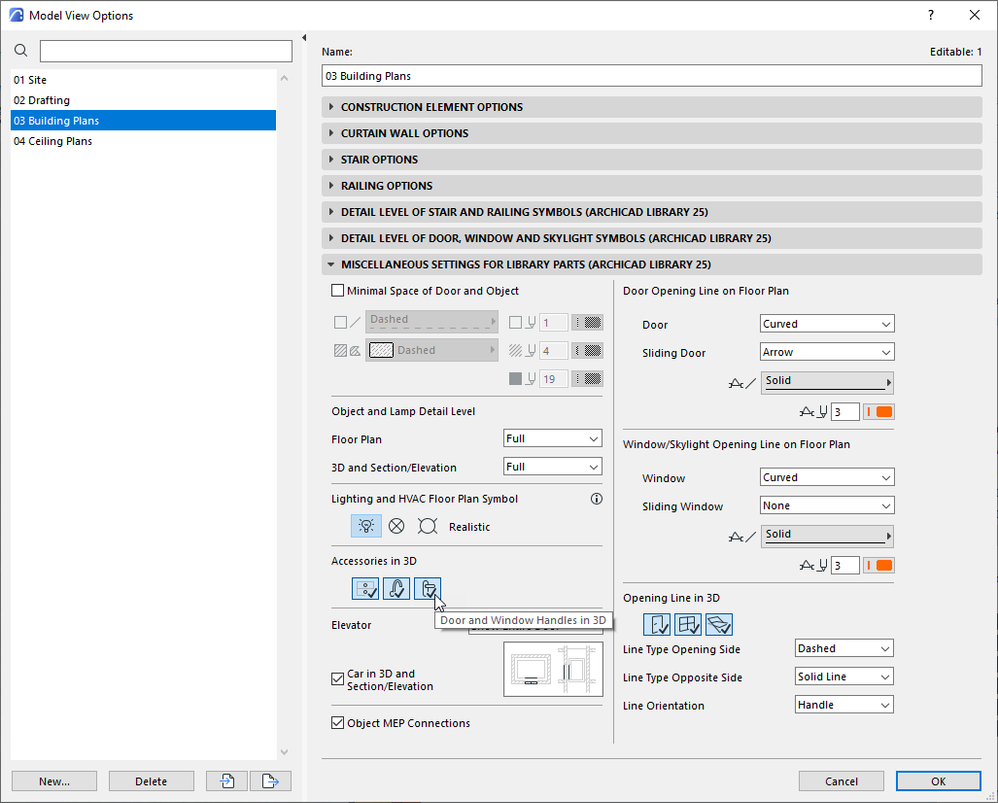

Did you check the last section of the model view options?
There should be an option about accessories where you can choose to show the door handles.
Hope it helps!

Hi Mathieu. Thank you for your comment. Yes, I did. It didn't work. I'm afraid there's a kind of an issue with the library. Because I couldn't find the solution so far. I'm not sure what else to check... 😢
It works fine for me.
Is this button (Door and Window Handles in 3D) enabled in your Model View Options Dialog?
Vallita Costantini
Hi Laszlo Nagy
Yes, that option is enabled. The issue should be somewhere else.
If you try to do this in a brand new file based on the default Archicad Template after a New & Reset, does the panic bar show in 3D?
For some reason, now they appear!!! It got fixed automatically. I left the file closed for a few days.
they did show on the 3d preview, but they didn't in the 3d model. Now it's sorted, but I'm now sure how or why. Thank you!
