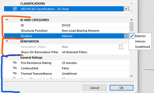

My door schedule lists the position. Exterior and interior.  Which is already set up in the door object.
How can I add' Garage' to this drop down function?
I tried searching position but in the properties but can't find it so wondering whether this option comes from somewhere else

i don't think you can...
the properties grouped in ORANGE are hard-coded into each 3D element, apart from the Element ID, which is customised.
the properties in BLUE & below it are all derived from the Property Manager.
hopefully i'm not jumping the gun, but if i can understand what you're trying to do -- you're trying "semi-manually" add room locations for each door / window using the Position property in the IDs & Categories Property Group. i believe those are coded into each 3D element & can't be changed.
what you need to be doing is to use Zones each with varying room names (Living Room / Garage / Kitchen) & have the doors & windows be associated to them by making sure they're encompassing the door/window that needs to be scheduled. then in the Schedule Scheme Settings, make sure to include the Zone name/number that these doors/windows belong to.

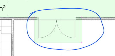

    • if you're worried about the Shed Doors being present in 2 zones (Shed zone VS Garden zone), we do the screenshot below:
      • yes, it goes way past the wall in a weird Gerrymandered way, but that's the point of these Room Zones. They are specifically for calling up scheduled items & not for area calculation -- that purpose is for the Building Zones.
