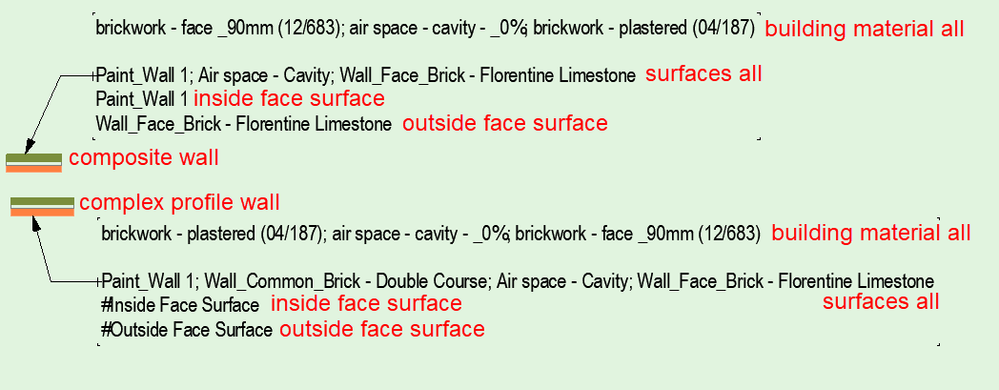

I built a wall with the profile manager, but I can’t use automatic labels to mark it. Please ask the experts for advice.

What information are you trying to label?

我使用剖面管理器创建了一个复合墙,我想使用标签来标记这面墙的表面和材料,我该怎么做?
English language only please.
Google translation ...
I have created a compound wall using Section Manager and I want to use tags to label the surface and material of this wall, how can I do this?

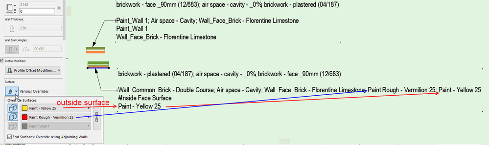

Complex profile walls do not have in inner and outer surface because they can have many surfaces.
You can label 'All' surfaces (just not individual ones)

Thanks! Do you mean that the composite section wall can only customize the surface material?

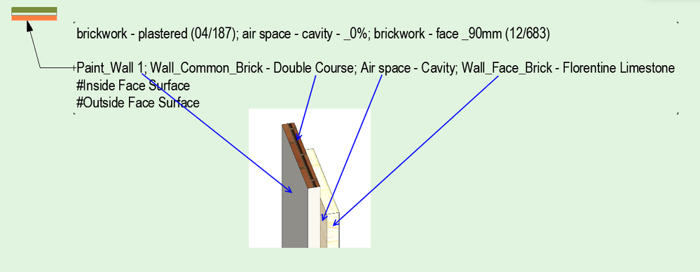

The inside and outside surfaces of a complex profile wall are treated as one and are labelled with the outside surface.
You can not pick and choose to label only parts of a complex profile wall.
You can only label "ALL" of the building materials and/or surfaces with the one autotext.
The building materials and surfaces it will show are as you have set them up in the complex profile.
If they are an exposed surface, they will be listed.
