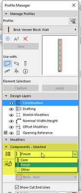

@Rve wrote:
Also the build-in visibilty of ‘Core’, ‘Without finishes’, etc. does not apply for walls that are not composites.
It should apply to complex profile walls as well.
Each fill/building material can be set as core, finish or other.
Only 'basic' wall structures can not have this option, so you just create a composite with a single skin as you want it.

True Barry Kelly, this is the only way to do so. Still I would like to see individual skins to be controlled by their own layer instead of one over-all layer.
