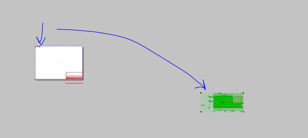

When I drag a view on a new sheet, the name of that view is always some random location and the text is always window sill. I am sure i did change it once but not sure how that got saved. Is there a way to reset all that?

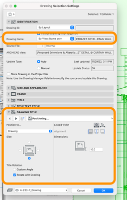

I am not sure if there is a way to reset but my workaround is to use the 'pick perimeter' tool (Alt+click) and that would become your default Drawing settings.
Just be sure that your Drawing Settings are set-up the way you want it. I think your setting should be like the one shown in the screen-cap below.
Hope this helps!

The quick way to reset the ID & Name values to default is to go into the Drawing Manager, select the Views you want to change and the click on Settings at the bottom of the dialog window.
‎2022-11-29 04:12 AM
Open the settings for the Drawing Tool and check the Title and relevant settings.

‎2022-12-02 04:00 AM
I knew it was something simple, hat setting was changed, thank you 🙂
‎2022-12-02 12:03 PM
