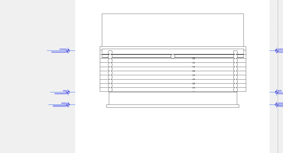

what controls the difference between the 2 images below? having difficulty understanding all of the different override variables, layer combos, and other various features that AC is cluttered with and just trying to simplify my process.

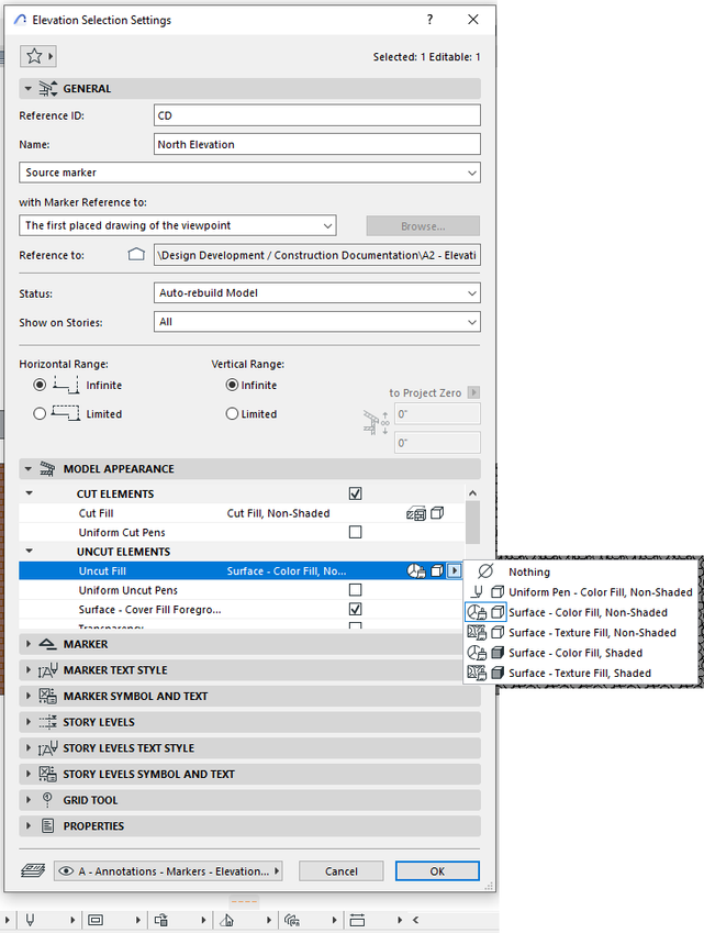

As @RobPhill33 mentioned, you can take a look of this help article where you can see the differences:

Try going to Elevation Settings > Model Appearance > Uncut Elements > Uncut Fill and play around with that setting.
