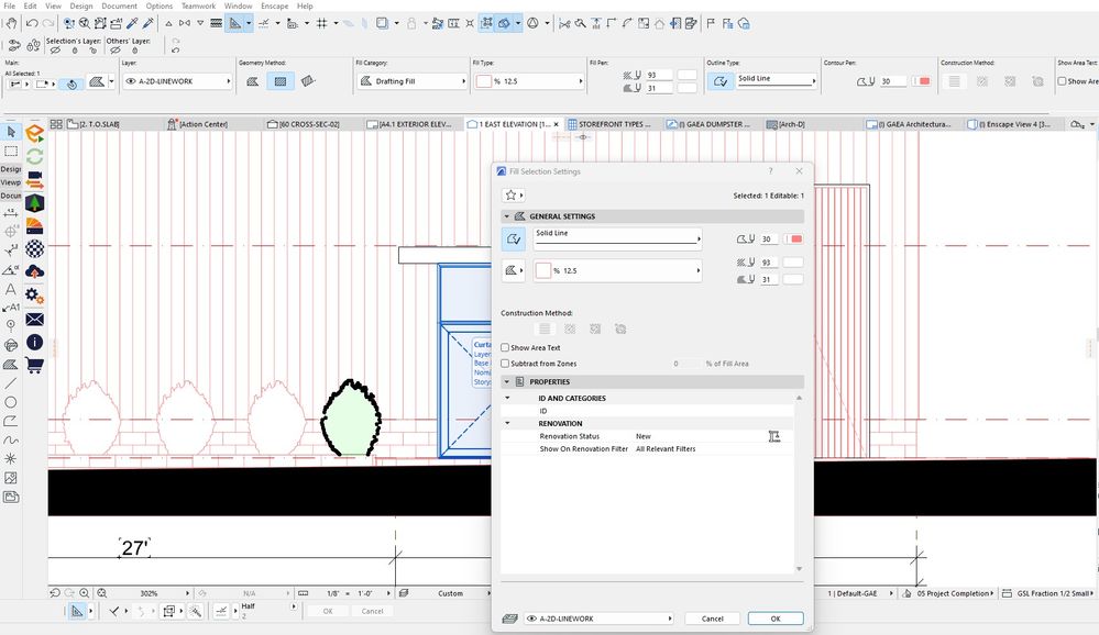

Attached is a screenshot of an object (bush_ created with the fill tool.  I chose 12.5% transparency for the Cover Fill, but it is showing as opaque. Any idea why?

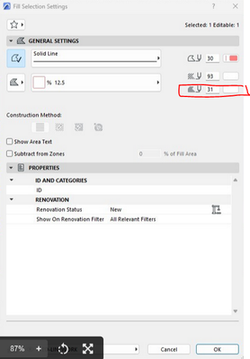

The background color needs to be transparent, set it to 0
