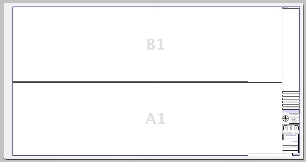

Still new to the program but getting more comfortable. Silly question but I set up two different master sheets (24"x36" & 24"x42"). I started with the 24"x36" as a master sheet and then needed to switch to the longer sheet as it gave me more room for a long house. The problem is that the shorter master is still displaying with the longer sheet. When plotting only the longer one plots so I can get work out but it is pretty annoying to see both masters on the layout view. It must be something very simple that I am missing, any thoughts?

Can you possibly post a screen shot of what you are seeing?

Here is the layout view. Two master sheets but only the correct one prints.
Will add the blank master next.
Blank master

Can't say I have seen this before.
The only way I can replicate anything like it is to set a second master as a trace reference - but then it appears with different colours and not the background master colour.
In your layout page swap the master for the short one.
Then change it back to the long one.
Other than that I am at a loss.
We get this also and have since 13 or 14. Always presumed it was a bug. We generally just drag the drawings to a new clean layout.
The ghost master remains even if the file is closed and reopend

Did you find a cause/solution to this problem? I have had the same problem since upgrading to v17. Creating new layouts with the chosen new master is a work around but extremely annoying when working on documents with large numbers of layouts.
A solution would be great!
Thanks.
Nope. It still happens and the only way I can get around it is to completely delete the drawing sheet and make a new one with the correct master layout. Unfortunately just switching the settings doesn't seem to work for me.
still no answer from Graphisoft even though they said they would look at it.
Ok, well at least I now know it's not something I'm doing! So annoying though. I guess it's a bug? Hopefully Graphisoft can/will fix it at some point...
