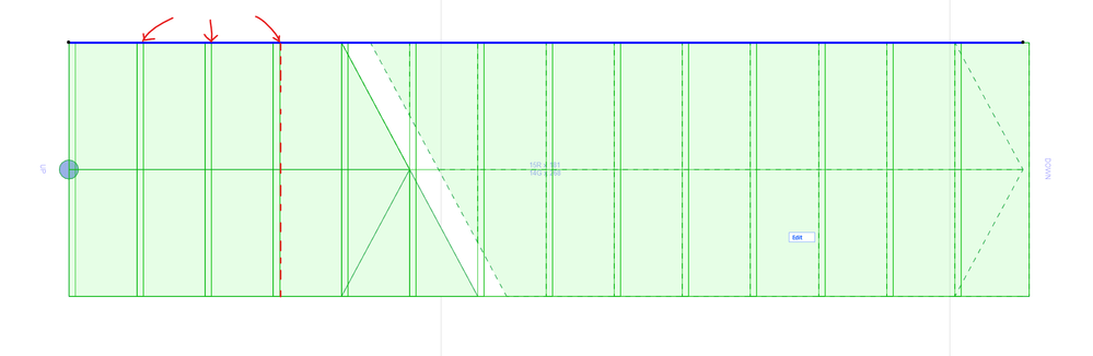

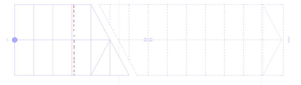

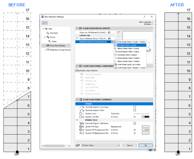

I'm trying to display the hidden part of the Stair Tread as per the attached images.
I have tried a number of combinations of options in the Stair Selection Settings and also the Model View Options, with no success.
I'm quite sure I've seen this line displayed in my own projects before (and have battled to hide it). There is an example at the Archicad help center that shows the line I am talking about (also refer attached image).
Does anyone have any guidance to offer?

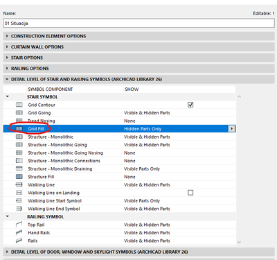

Try grid fill to none in MVO settings
Archicad 26, build 3001
Montenegro
Thank you for your thoughts.
This is one of the options I have tried, to no avail. Does it work for you? Perhaps it is a clue as to why mine isn't working...

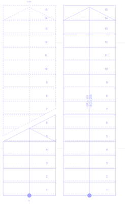

Hi Paul
Is this perhaps what you are after?

Thank you for your thoughts. What you've shown is not quite what I'm after; the attached image shows the result I'm hoping to see (I've used the Non-Slip Accessory from the Tread Accessories and tweaked the settings so that it lines up with the start of each riser):

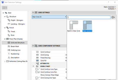

This is the solution, thank you.
Part of my problem is that I was using the Built-In Stair Grid, which does not have the options for Tread Nosing line types. Thanks to your helpful video I could see that I needed to be using Stair Grid 25 (I am using AC25 for this project):
