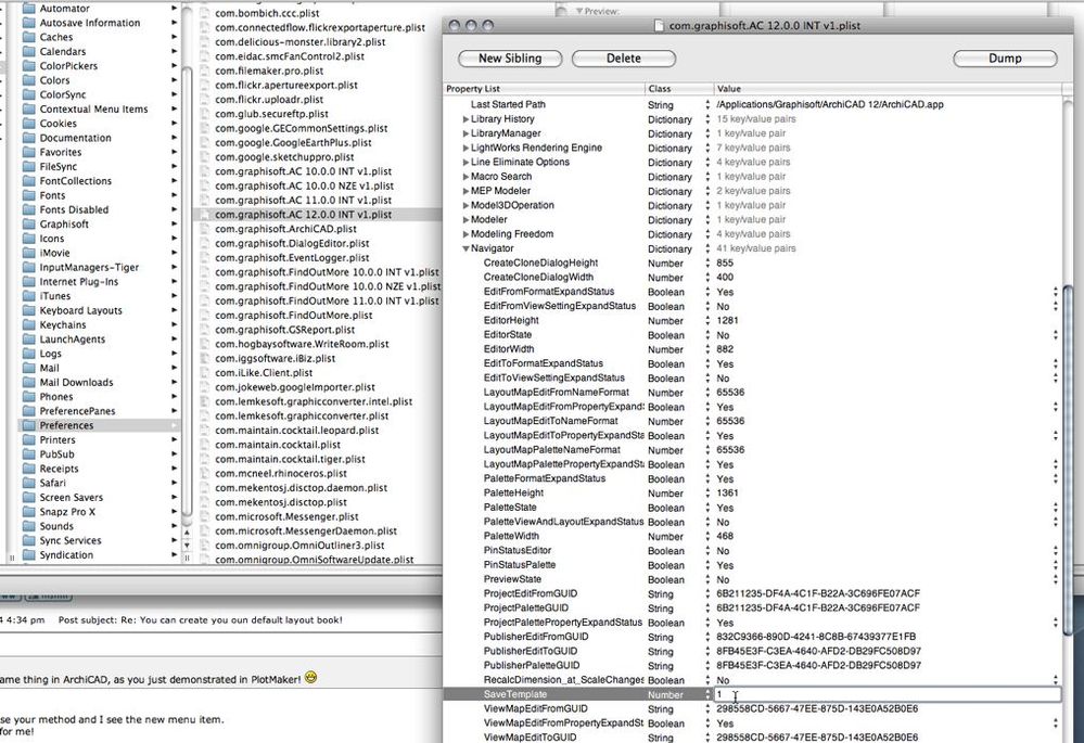

you can do the same thing on a mac by editing the plist file for the archicad version you're using. there are several free or shareware 'plist' editors out there, but i use the one that comes with the apple developer tools: 'Property List Editor'.
find your archicad preference file here ...
<your user home directory>/Library/Preferences/com.graphisoft.AC 12.0.0 INT v1.plist
... and double-click it - if 'Property List Editor' is pre-installed it'll open, otherwise open it with whichever app you can find to do the job. (actually, i think any XML editor should work but don't quote me on that!). you'll see all of the same tweaks that are available to you using the REGEDIT stuff on windows. see the screenshot . . .
hope that helps!

I'm back again guys,
without any good results though ...
Susanne wrote:
... anyways, let me try it out and get back to U and Link with my results.
the "PNTemplate.bin" that is created - and that I rename to xx.tpl to then re-open through the File > New dialogue - does not remember the Navigator palette's settings. Any clue U 2 smart duds?
I'm quite sure this worked in older versions
__archiben
now that i try it, i can't even get that far . . . whenever i try to open the resulting template file i just get the 'unknown document version' alert. maybe because i'm running without a dongle at the moment . . ?
