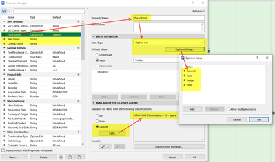

2. You will need to read up on Classifications & Properties.
You classify your zone and you have properties that are linked to that particular classification.
Those properties become visible to any zone that has that particular classification.
So you would create properties (in Property Manager) for floor finish, wall finish and ceiling finish.
They can be a simple 'string' value in which you can type anything, or you can add an 'option list' where you can create a list of options to choose from.
Link those properties to a classification (such as 'Spaces').

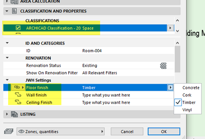

Place your zone and set the classification to 'Spaces'.
Now that zone will have those 3 properties and you can type values or choose from the pre-set list.
Those properties can now be show in the label - the zone label 25 has the ability to show properties.
The zone shown is in plan, but you can label it is section too.
