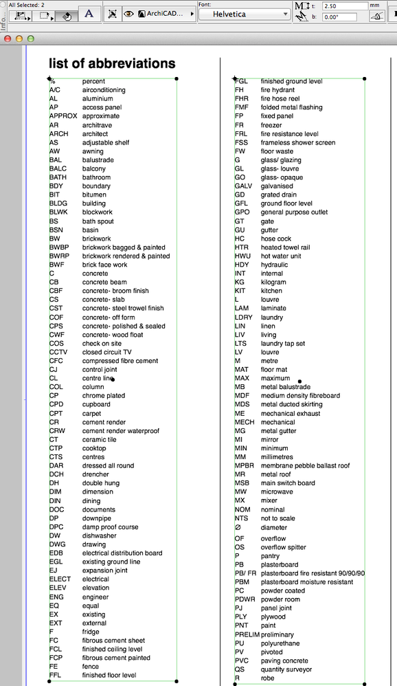

Just wondering if there is a way using either the Interactive Schedule or Indexes to list a series of abbreviations, so That they are live and coming from one source when you need to edit, remove or add abbreviations?
Ie. Instead of using the text box on the layout and having to copy to each master layout for each different page size?
See screenshot of current situation.
Many thanks in advance.

I use Word, save as a PDF and place the PDF as a drawing on the sheet(s) that need it. Extra step to edit and re-save if abbrev changes, but I rarely have had to edit the file. The placement of the common PDF file keeps everything the same.
If you want to create it purely in AC, create a Worksheet with your text and just place an appropriate View of that worksheet with the Drawing Tool onto the sheets / masters that need it. Linked and live at all times (unless drawing updates are set to manual).

I have gone with creating a single text box list on a worksheet and placing that on the layouts in such a way that when I edit the worksheet by adding or removing abbreviations they automatically shuffle and no further editing is required.
It's great, thanks again.
