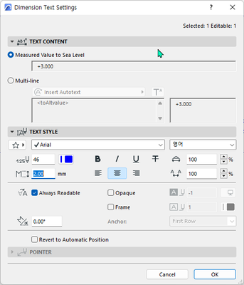

DGSketcher gave the method... but here are screenshots of the steps.  After placing the dimension, select the dimension text box (NOT the dimension itself!), right click, and select Dimension Text Settings....  You will see the multiline option there.
