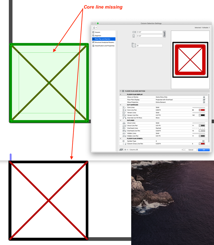

I need to display the column core and veneer lines.  For some reason only the outer veneer lines appear.  Please see the attached screenshot and advise.  Thank you, ScottScreen Shot 2021-10-01 at 6.27.39 AM.png

@Scott Bulmer have a look at your Graphic Override settings. You will probably find a cut fill override with "Show skin separators" turned off.

Thank you, I double checked but that was the setting was set as 'show skin separators' for all renovation conditions.

A bit unclear what’s going on. The X plan symbol usually only covers the core so at first glance I would say that it’s the veneer line that’s missing and that you should check the Partial Structure Display setting.
But PSD also affects the preview in the settings dialog and then there’s the hidden outline that shows when selected. How is the column position in relation to other elements? Do you get the same issue if you just place it by it self?

I apologize, DGSketcher answered correctly.  Earlier I only changed the Renovation setting to include Skin Separators that had no affect.  In addition I also needed to change the Graphic Override as well.  Thank you so much for the help.  All good now.

So Graphic Override > Fill Type - w/o Show Skin Separators extends the Floor Plan Symbol across the veneer. Rather odd that that and the skin toggle can't be done in the Column Settings.
