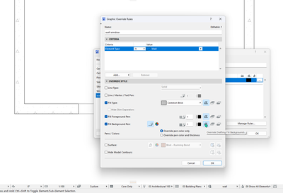

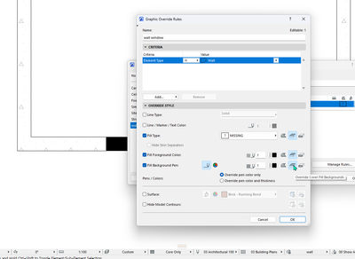

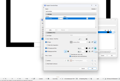

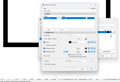

Hello,
Not sure if I understood correctly but it seems like you want to override the portion of the wall that is uncut, and showing whenever you have a window or door placed.
You can override it in this way:

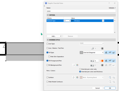

Draft Fill
Cover Fill
Cut Fill
I still don't know how to use draft fill.
And I did this far yesterday.
So I thought no. ^^
Because I only use it with everything turned on lol
I appreciate your interest. ^^
