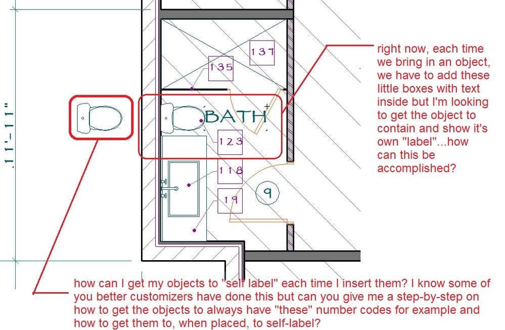

see attached.
How can I self-label the objects (set them up) so when they are inserted they already come in with an associated "label" and tag?

Since the Label element is now independent of the element it Labels you will not be able to place the Label at the time of placing the Element. I would suggest setting up a Label (or Labels) and select all Toilets, etc. and use the Document\Document Extras\Label Selected Elements command.
The other option is to modify each of those Objects to contain a text that would display the desired piece of information. For that, you would have to a) create GDL parameters to control the content, font type, font size, exact location of the text within the GDL Object, and b) use the TEXT2 command in the 2D Script to place the text within the Object.
If you ask me I would use the first option as it can be used with any object, while the second would have to be repeated for each object you want to display text in.
