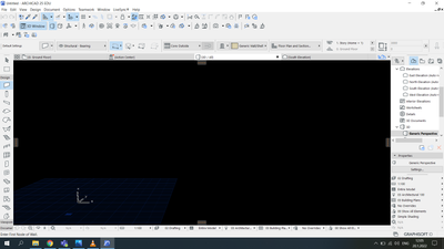

How to solve all black 3d window?
Please, can someone help me solve this problem?? I changed the engine and it didn't work
2 Replies 2
Check the "3D Styles" Dialog by right-clicking the "3D" Tab, then selecting "3D Styles > 3D Styles" in the context menu that appears.
In the "Background" panel of the Dialog, are your sky color and ground color set to black?

Do things you build still render in fine?
