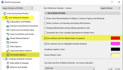

We have just upgraded to Archicad 26 but everything on the Master layout is in bright red, even though clicking on them tells me it is the correct line weight and in black - how to fix please?
All the drawings etc are fine.

Best to always start a new post if not really related to the other issue.
I replied there but will reply here as well.
That is an option in your Work Environment settings.

Sorted thanks.
