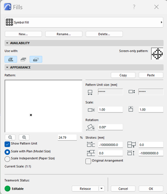

Hi there,
I experienced a similar issue where the published PDF was visible on an online PDF viewer but not Adobe PDF reader. After looking into the problem, I have figured out what was the issue for me. In one of the composites, a building material was using a faulty fill (see the attached picture below). Using another fill for my building material resolved the issue.
