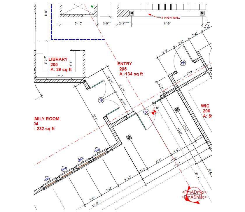

You can only look at a section in one direction. You can have a breaked section.
But maybe it is a work around to create 2 sections and place them adjacent on a layout?

I had the same task.
My way was create two section on the same ID later will joint it in layout.
or you can use the Interior Elevation tool

Why not do a 3d cut and turn the viewpoint on to a side view?
