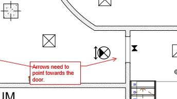

I wanted to see if anyone knew a quick fix for these two items below. I am using ArchiCAD 19.
1)Power/Data plans
I wasn't able to fix the exit sign arrow issue (image attached). I am being asked to change the arrows to point towards the door.
