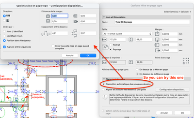

@Lingwisyer the premise of hotspots on the master is that I locate them at all the likely intersections of where I have guides now?
@Erwin Edel interesting, I never thought about disengaging the titles themselves...that certainly makes the drawings more intuitive as frames for the layout.
@BrunoH i like the idea snapping to a grid, but not the auto-numbering part. Also, I still want gutters (spaces between each of the drawings). Is there a way to set a 1/4" (10mm) gap between grid positions? So, drawing frames do not touch?
[And i like trying to decipher the international backgrounds with my [american] high school french 🙂 ]
thanks for your replies!

‎2023-03-21 04:12 PM - edited ‎2023-03-21 04:30 PM
Boom! I think that's it!
I'm going to see how that works. Thanks for getting me pointed in the right direction!
well, maybe not...i cannot see what that spacing setting actually does when inserting drawings
