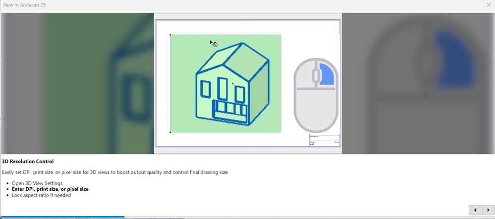

Just a quick update:
I'm very pleased to see that this is now one of the new features of the 29 Tech preview!

Oh, that is nice surprise. I do not recall seeing it on the roadmap, even though there have been wishes for it for years... It has always seemed like such a high value to required effort wish.
