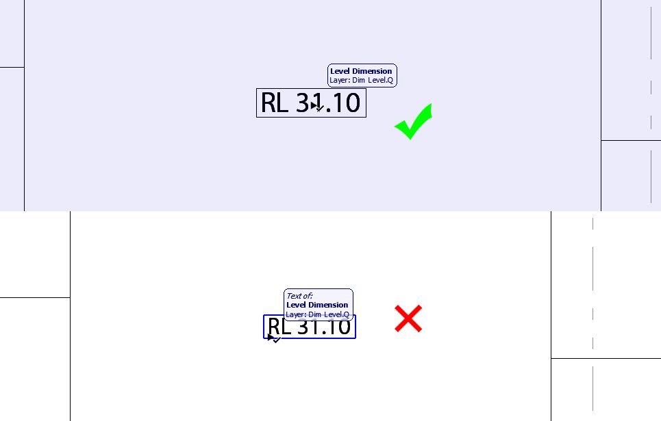

teo wrote:Is it maybe on a locked layer? When you select it, how do the selection dots look?
I Have a level dimension on the floor plan which i cant delete. I have moved it off to the side so that i doesnt print. Is there a way to delete it? Other level dimensions are fine, there is only 1 like this.
‎2006-08-17 12:29 PM
‎2006-08-17 02:44 PM
‎2006-08-17 03:39 PM
‎2006-08-17 04:44 PM
‎2006-08-17 07:35 PM
‎2006-08-18 08:36 AM
Srinivas wrote:If you don't want any text but do want the dimansion (can't see why, but then ...) just select the dimension text (there is a node at teh bottom left, if your handles are on you will see it) and type in a space.
You cannot delete just a dimension text alone in ArchiCAD, you have to select the arrow mark to delete the entire dimension.
