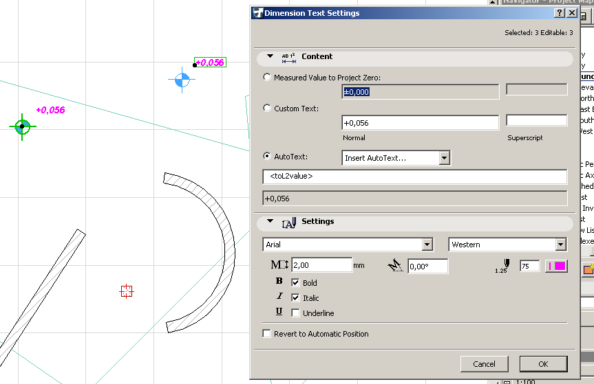

How to Modify Dimension Texts of Several Level Dimensions
a Techtip contributed by László Nagy (Original tip: https://community.graphisoft.com/t5/Document-Visualize-forum/Level-dimension-to-sea-level/td-p/36268...)
When you want to modify all or even some Level Dimensions in your project say in a way to make them refer to Reference Level 2 instead of Reference Level 1 (please see the Manual for more details on the Reference levels!), the obvious solution would be to select all text boxes then change them in one step. However, when you select all level dimensions, the dimensions themselves get selected and it is the Level Dimension Settings dialog that will open when double-clicking on the Tool's icon or pressing Ctrl+T (Cmd+T on the Mac).
In order to make the Dimension Text Settings dialog open, instead of the above mentioned one, you need to do one simple step prior to opening the Tool Settings dialog: having selected the Level Dimensions you would look to change, just add a single Dimension Text to the selection as well. In this case, the Dimension Text Settings dialog will open when pressing Ctrl+T (Cmd+T on the Mac) and all changes made in that window will apply to every selected Level Dimension. In the screenshot below you can see the Dimension Text Settings dialog open, when the selected Level Dimensions are set to refer to Reference Level 2.
To do this, simply click on the Insert Autotext checkbox, open the pull-down menu to the right of it, and select the option you want - in our case Reference Level 2.

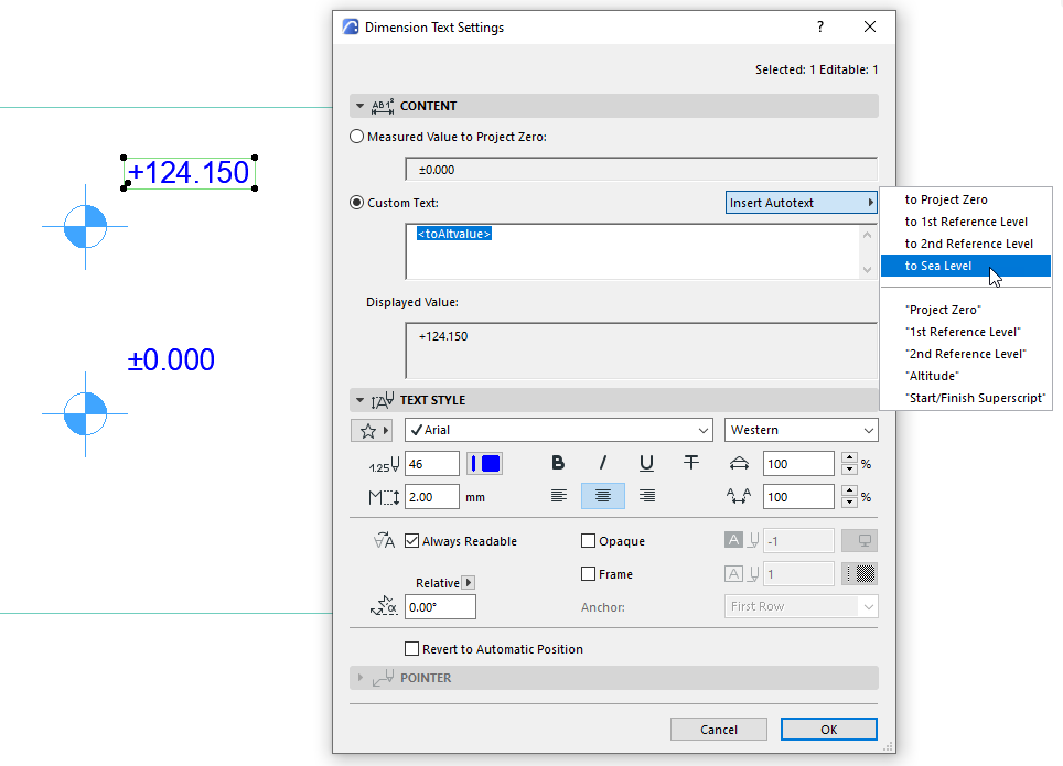

We use the Level Dimension Tool to identify the elevation of our slabs. This works great when identifying sea level in our story settings. Recently, we have changed our workflow, at Graphisoft's recommendation, to keep the story settings at project elevation (ie. first floor = 0'-0") and adjust sea level in the Location Settings. This seems like the ideal way to go as it will allow you to change the first floor of your building, as it relates to sea level, without affecting the model. Even elevation and section marker Story Settings can be told to read sea level. But what I have lost is the ability to tag slabs in plan with the Level Dimension Tool to show elevations relative to sea level...which is our (and industry) standard.
Is this possible to do? Am I missing something? I know you can force the dimension by inserting autotext, but that doesn't make sense. You can't work that into a favorite and you'd have to do it everytime you place a Level Dimension Tool tag.
Why doesn't this tool have the option to adjust to display the elevation above sea level like the dimension tool?
Dimension your Slab with the Level Dimension Tool. Then select just the Dimension Text of the placed Level Dimension, go to its Settings Dialog, select the "Custom Text" option and select the "To Sea Level" option, and the top elevation of your Slab will be displayed relative to the Sea Level instead of the default Project Zero.
ksjhawk
Thanks Lazlo...
I know this, but it requires you to "force" the elevation with auto text and you are not able to make this a favorite or even eye dropper it to use in multiple locations in a plan. I hear a change to this is coming, but thank you for your response.
