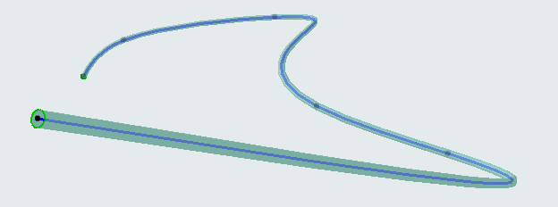

I've spent roughly a day struggling with Graphisoft approach of handling items naturally should be equipped with appropriate length calculation. After all found a gdl library modification at Russian forum, which adopted for 27th version. Works more or less according to expectations. The follwing code is to added at the bottom of the "Parameter" section:

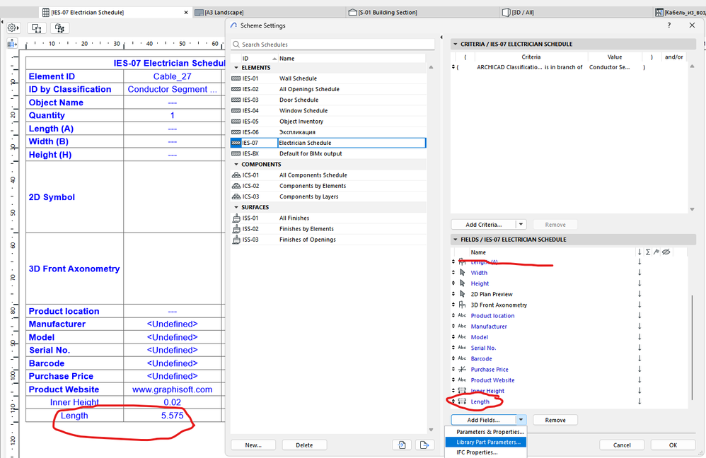

So the steps for interested ones:
1) Open File -> Libraries and Objects -> Open Object -> MEP Library 27 -> MEP Library 27.lcf -> 1. Ductwork 27 -> Segment 27 -> Flexible Duct 27.gsm
2) Under "Parameter" section paste the code above
3) Save the modified file e.g. as "Cable_from_duct_27.gsm"
4) When at your drawing, select Design -> MEP Engineering Tools -> Ductwork -> Duct Flexible Segment and in Settings Dialog select your modified object "Cable_from_duct_27.gsm" as the one instead of standard ArchiCAD's object
5) Draw your duct in a desired way
6) At Schedule -> Scheme Settings select (instead of standard "Length (A)") a "Length" field under "Library Part Parameters..."
The result is visualized at the attached pics, though it's not the perfect one.
Maybe I missed a much proper and easier approch of handling lingths of cables/ducts/etc, but I've really endeavoured. If this is really the only solution, then a big shame on Graphisoft for missing such evident and easy-to-make feature.
