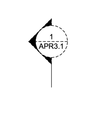

I found this on a few other threads, but as old thread resurrecting does not seem to get any traffic, I'm going to post this here. (this goes back to a thread from 2005, so apparently it's an issue that was as old as my experience in Archicad?).
maybe file it under bug reports and wish list items? I don't know any more...
Markers continue to lack line type definition. there is a line type in the settings, but it apparently does nothing? I don't know.
Other than setting up a graphic override rule to turn all lines to solid for section/elevation/interior elevation markers, does anyone have a solution for this? what index number is it supposed to be? This is after attribute matching my migrated template to the AC27 default attributes... so I'm at a loss on this... again.
