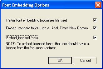

Have you tried setting the Font Embedding options in the Advanced Panel of your Amyuni Printing Preferences?
Do it via Start>Printers & Faxes> right click on Amyuni> Printing Preferences. This way it will stick permanently.

I tried that, and i'm still getting the same error.
It's only happening with the Arial regular font (arial narrow works), and only Text boxes that use arial font (dimension strings with arial labels still print).

It's included in the Font Embedding Options, so one wouldn't think so. Sounds like a more specialized problem. Is the font definitely on your machine? It doesn't appear as [Arial] does it?
