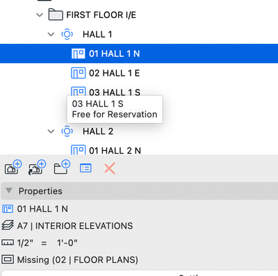

I'd like to add that this is even worse, as the MVO's will show correctly in the drawing manager, but in the view summary at the bottom fo the navigator, it will show something like : "A2 - Floor Plans [Missing]"... and A2 - Floor Plans is most DEFINITELY NOT missing!

just to further demonstrate the issue:

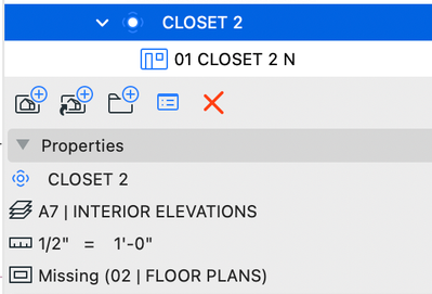

Shows missing in navigator properties:

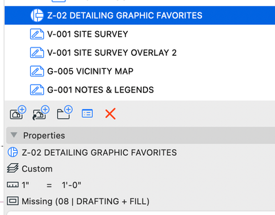

Shows missing in view settings:

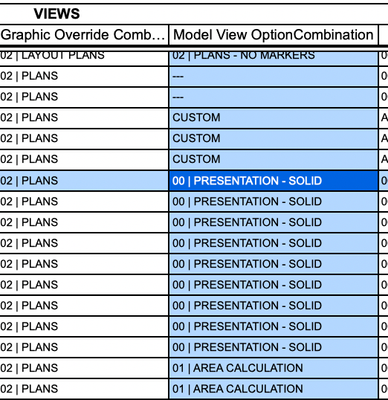

Does NOT show missing in view list:

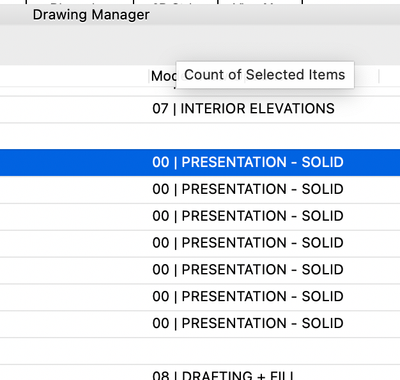

Does NOT show missing in drawing manager:

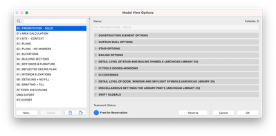

Model View Options are not, in fact "missing", except for in the view settings:
All this said, the views randomly apply whatever MVO settings the software feels like... if your MVO is set to show door/window markers, they wont show when they are missing. If your mvo is set to show cabinet or door operations in elevation, they wont show when they are missing.

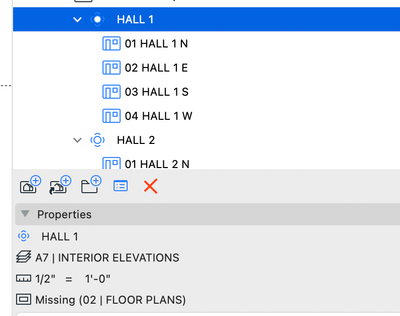

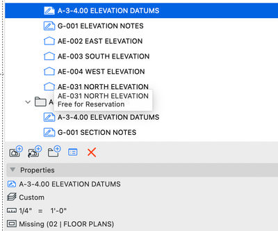

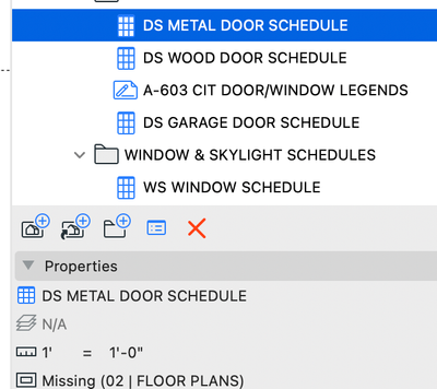

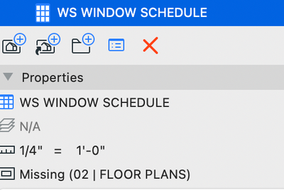

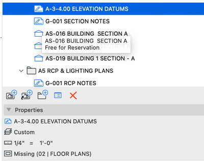

since this is still getting the crickets... I'll bump it again... here's a file I'm working on today. Most worksheets and schedules in the view map are missing their MVO's, and ALL the interior elevations are... anyone here from GS or with connections to GS able to relay the crucial need to get on top of this?
 (here is a small sample of the views in the file missing the MVO setting)           
