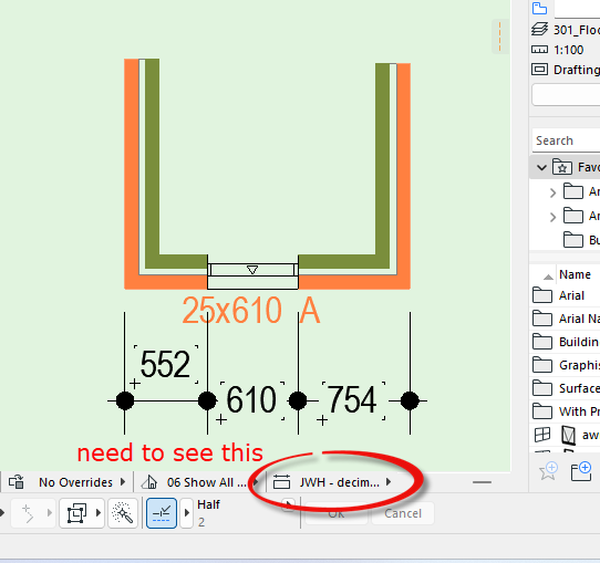

Can you show a screen image of your dimension style settings, showing the settings for the fractional dimensions.
Like this for example...
Then also a screens image of the view settings so we can see if the correct dimension style is applied.
Also a screen shot of you wrong dimensions when the correct dimension style is applied.
