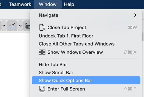

I believe you're looking for Window > Show Quick Options Bar

Yes, thank you!
