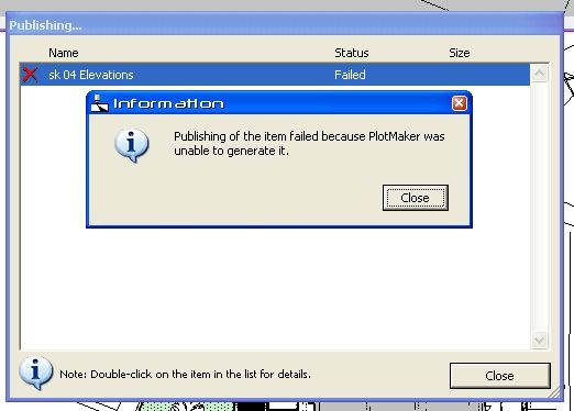

Trying to create a PDF file from PM Publisher. I am following the same steps I always have; drag the layout to the Publisher window, tell it where to save the file (in "View Set publishing Properties"), set page options and document options the same way I always do, then hit Publish. What happen next is intriguing. The PDF comes up as "failed" with error message as attached, and my printer spits out a drawing which it has compressed from A3 lanscape format to A4 portrait, which is mildly amusing in itself.
I tried the same file on another machine and all was well, PDF created normally. No drama.
Back on my machine I tried a different LBK, one from which I had created PDF's many times, and got the same "failed" message, and A4 size compressed drawings.
Has anyone else experienced anything like this?

This looks like the kind of thing that comes with a permissions/access error. Are you sure you are saving it to a directory that you can write to?

Have had issues before with permissions, but can't think why this would have happened now. I can still save the LBK and PLN files o.k. to the same locations. I was able to make PDF's yesterday. I haven't changed anything at this end, but our system consultants do have a history of making little alterations for us from time to time. I shall give them a call.

Is it anything to do with the default settings of your PDF converter?
i.e it is set to an A4 page or is set to scale at 50% or something?
Can't say I have ever published to PDF, I always just print my layout book to PDF.
Don't really know what it is to do with. As i said, I just set the thing up the same way I always do, but this time got the error message, even when trying to redo a previously set-up (and working) PDF set.

This sounds like it may be similar to a problem we discovered a while ago. Our symptoms were that we were publishing to PDF but somehow the PDF files weren't generated and instead the drawings were printed on a physical printer.
Long story short...When you open a session of PM or AC the temporary archicad/plotmaker printer gets created. When you shut down AC/PM the temporary printer is deleted. So, what happens is that if you open 2 sessions of PM and then shutdown one of them, the temp printer is deleted and the remaining session is left without one. Somehow, it will instead print to the last used printer.
To see if this is your problem check and see if the temp printer is there. If not you can startup another session and it will get created again and you should be able to publish again.
