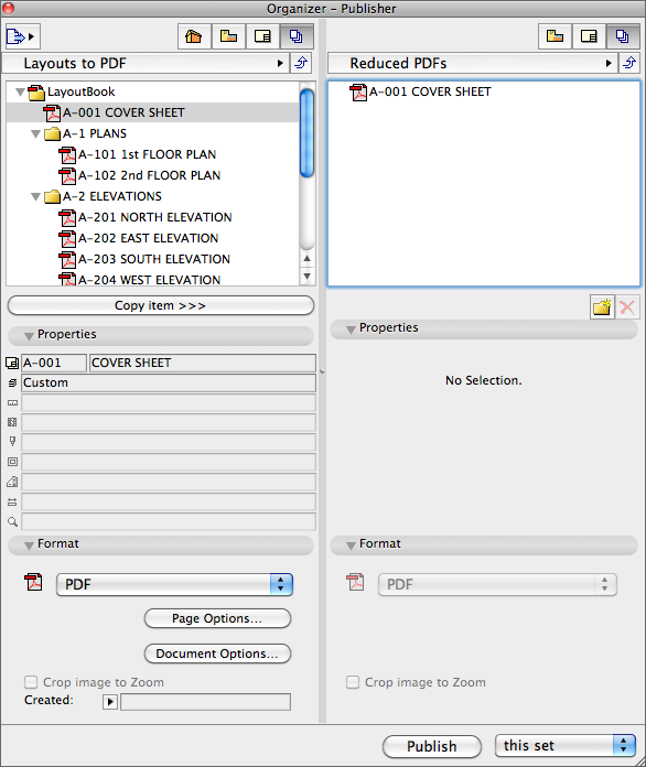

Is there a way in the Publisher to take a full size (36x24) PDF Publisher set and re-publish a new set as 8 1/2 x 11 PDFs?
The Organizer suggests there is, since I can show the Publisher on both sides of the Organizer, create a new Publisher set on the right, and see options on the left side for PDFs called “Page Options”. However, selecting PDF formatted layouts on the left and changing page options before copying/drag/drop to the right doesn’t seem to do anything - it always defaults back to the original page size. Attached is a screen shot of the Organizer, using the AC15 template file.
I feel like I’m missing something. Perhaps “Page Options” works for something else. I know there are other ways to do this.....just wondered why it won’t work with this method. Can’t find any help in the Reference Guide.

I've never tried this before but I notice the same unexpected behavior you describe (the page settings don't stick). Actually, in a weird GS sort of way this may not be too unexpected since they are grayed out right in the organizer pane itself (see below).
However, all this begs the question: why worry about it? One of the reasons we all love (and hate) PDF is that it scales to whatever the output size is. Your 24x36 is going to print just fine to 8.5x11. Many folks have a note on the title block that says something like "scale as shown only when printed to full size 24x36" or whatever....

I've found AC works for a lot of things besides construction drawings, and this is a file I created for some presentation boards. The layouts I created were huge in terms of megabytes, and I was experimenting to try to reduce file size to send individual layouts by email.
Which may or may not have worked, based on past experience. But I ran into this problem, instead.
But you are right....otherwise no need to worry about it.

As Chazz mentioned, the document size for a vector format document such as an AC-generated PDF doesn't really affect the file size in MB. Same number of vectors/curves/etc.
One thing that can shrink a PDF file size is compression of images... So, if you convert the AC PDF to an image-based PDF and increase the compression, you should be able to get quite small file sizes. For example, opening the PDF in Photoshop, which converts vector to raster, then saving a fresh PDF from there (100% raster/image) - and either adjusting compression settings then, or opening in Acrobat Pro and optimizing the file is one method if you have Adobe CS.
