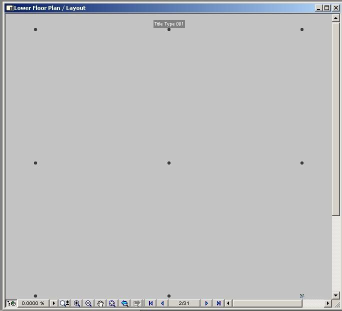

I am using PM3.1 with a Layout book that has "worked" in PM 3.0. If a PMK is imported into a Layout sheet and then a zoom all is selected the screen area turns gray with a "Title Type 001" Box at the top. See attachment. What is going on?
Also if an imported PMK is selected and I try to Edit>copy I get the error as shown in following attachment. I use to be able to copy and paste my imported PMK's.

The Size of the "improted" PMK's never was an issue before. They would always copy and paste. The also would zoom all correctly. Now with PM 3.1 and an imported PMK (note PMK is from AC 7.03, as I have always done in PM 3.0) somehow has a Tile Type linked to it. This template lbk did not have this happen in PM 3.0.
Titles are on by default; you can switch it off in Preferences.

The preferences state "Append Titles to newly placed Drawings." This does not seem to count for newly updated Drawings (or PMK's). After changing preference and reading all from folder again and updating, the zoom all is still "broken".

For the already placed PMK's (That some how com in as default "Append a Title to this Drawing" checked), In Drawing usage mode, select all PMK's and then right mouse click> Drawing Settings>Title bar: uncheck "Append a Title to this Drawing". If it is already unchecked, check than UNcheck the box. Now the zoom all works.
