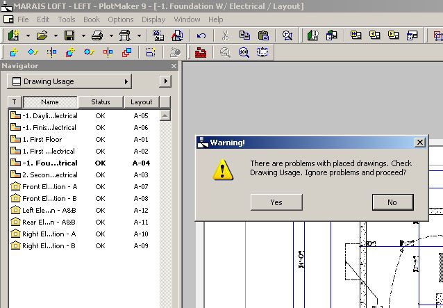

Erika wrote:This could be the case, because I know the .pln has library loading errors, I'll take the time to fix this and see if this resolves the issue.
If you have library loading errors you will also get that message.
s2art wrote:I'll try this option out as well.
I often get this when I have opened an LBK an not needed to update views (because they are already up-to-date.) If you save your PLN again and re-update your drawings in LBK you won't get the message.
