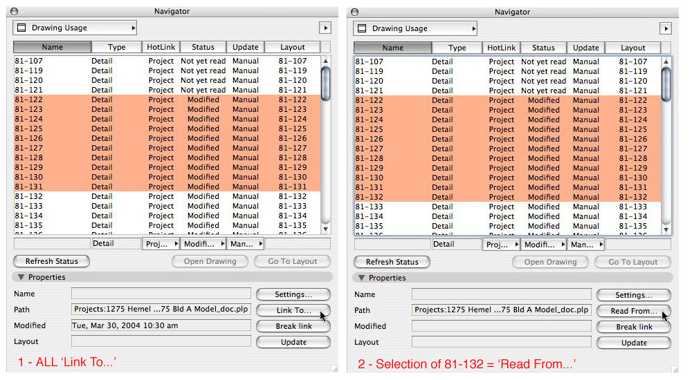

__archiben
Aussie wrote:
I bet if you look closely the file you deselect will have a different source to the others.
OK - look closely at the attached. all are details. all from the same viewset in the same archiCAD file.
on the left, selecting details 81-122 - 81-131 results in the 'Link To...' button being active, but selecting the next detail on the list as well (81-132) which is no different in its location, settings, etc as the others gets the 'Read From...'
selecting this last detail (81-132) on it's own will 'Link To...' just fine . . .
not a problem as such - a bit of a hasle and IMHO just another example of unnecessary UI confusion . . .
~/archiben
b e n _ f r o s t
Aussie John
Ben, Thats a little odd. Notice that the date modified occurs in one and not the other. That implies there is a file that has a different modification date to the others, but if the links are to the same file that is not possible.
