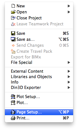

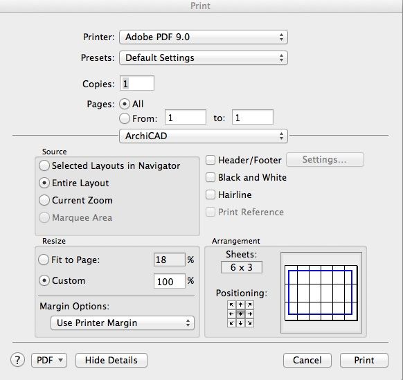

No matter how I change the settings my pdf are ALWAYS printed on multiple pages (at least 2 if I try to print an A3). How do I overcome this? Here I Am trying to print on an A1 and as you can see it does print the size of an A1 but on a million different A3 and I can't change the page layout somehow! I have changed settings for page setup and still doesn't work. changed settings in layout, in masterlayout, etc....getting desperate here
By the way I am using Archicad 1 on a Mac.
thanks for the help,
Pao

First item is that you should not print to PDF but use the Publisher to publish to PDF. Check the manual for more info.
Second Item. Have you set the Paper Size before selecting print? See image.
Third Item. In Mac OS you can use File-> Save As and select PDF for the current layout and it will create the PDF without problems. Difference between using SaveAs and the Publisher is that using Publisher you have more control on what, how and were you can create the PDFs.

I set the page already and also tried the Save As: this time the drawing is printed in "only" 2 A1 sheets. I guess it's an improvement....

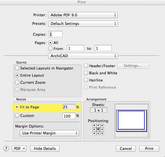

I regularly just print to PDF, using the publisher only for do full sets. the key to get everything to print on one page is to make sure your master layout margins are ≤ your sheet margins in the page setup. If in doubt, set go to page setup and set the sheet margins to 0

I have noticed that I can print in one page if I leave the "fit to page" on in the printing window. That way it works ok.

Hello,
I suggest choosing 'Use Layout Margins' -
not printer margins as shown in the picture.
Printer margins commonly generate mentioned
extra pages.
