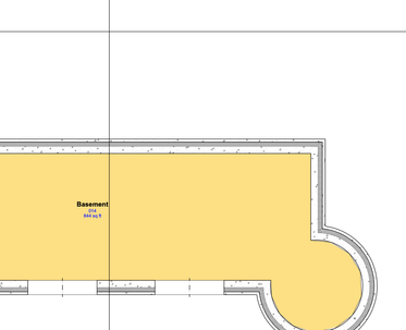

I'd like generate a pdf file from Archicad, with all the layers that I see in the 2d view window, including the grayed out image of my other layer(s), which I can turn on or off with View -> Trace. Having this "on" is great, as it gives a reviewer useful visual information about how levels relate to each other:
But when I try to print this to a pdf, only the storey that has the focus is printed, all the visual support information gets omitted:
I've searched high and low for an answer, to no avail. I'm using AC27, educational edition, on an Intel based iMac.
Please assist.

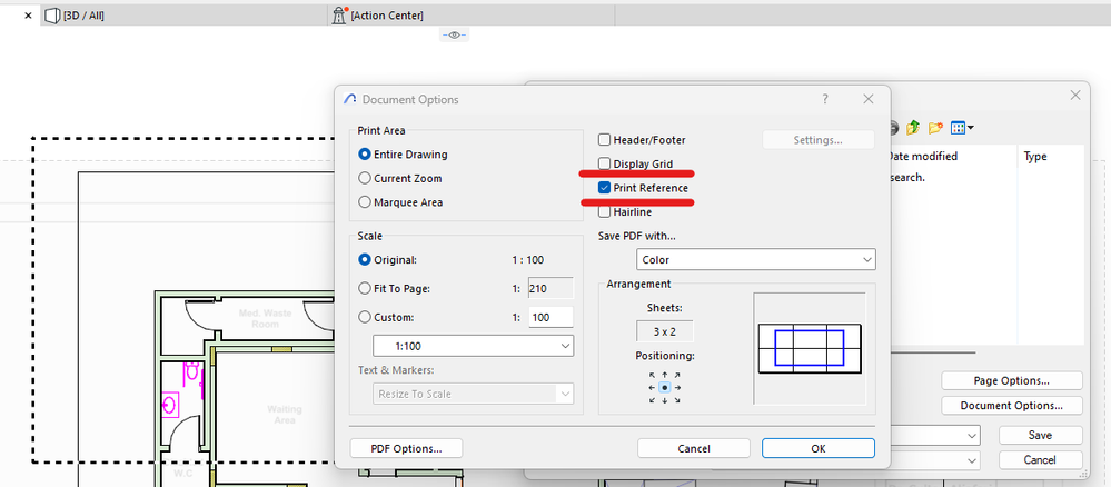

In addition to what @mthd suggested, there's an option to include the traced reference in the printed PDF.

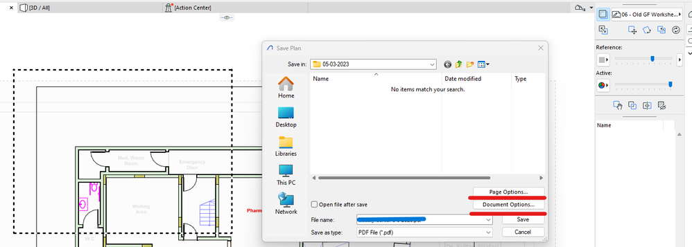

1) If you're using (File - Save as PDF) here's the option.

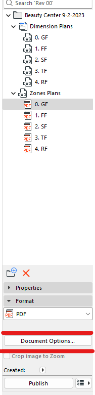

2) If you're using (Publisher from navigator palette) here's the option.

The second suggestion is perfect for me at my level. If I may make an observation to the AC people, I must have looked at this option, I probably looked at it several times, but how is a person supposed to connect words like "Trace" and "Reference" in his mind? I'd bet the average mortal would benefit from having consistent terminology. One word or phrase for one thing.
